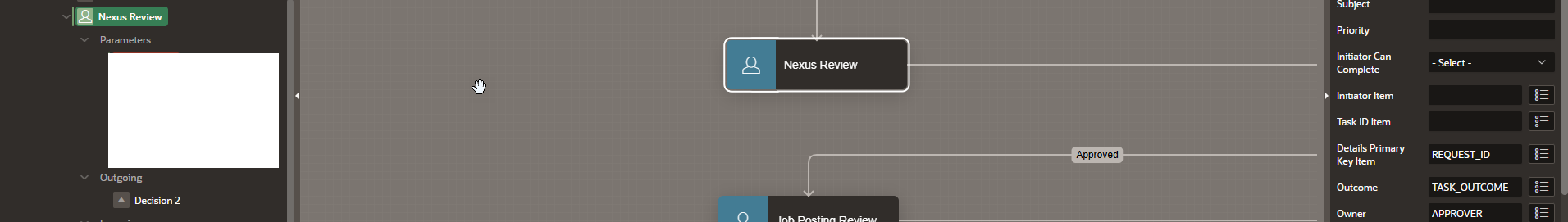

I am reaching out as I wanted to ask how this could be resolved or if this is an existing bug. I noticed very rarely and all of a sudden sometimes the parameters for tasks, within APEX workflows, seem to suddenly disappear for some reason (i.e. looks as if the task has no parameters).
For example, in image 1 (Nexus Task) it looks as if I have no parameters even though I did explicitly define in task definitions.

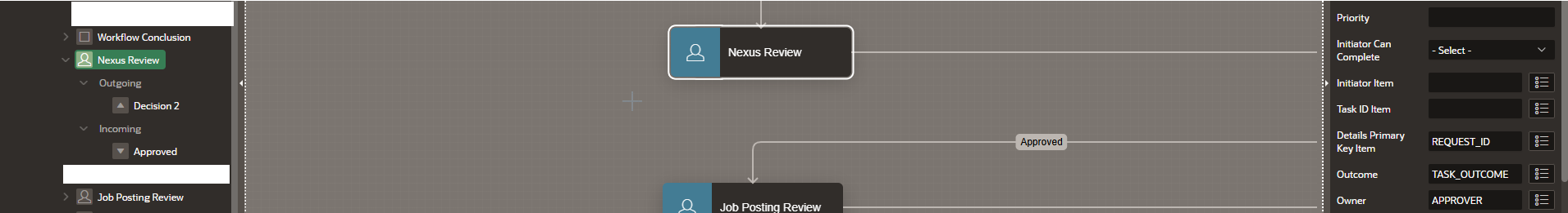

I noticed when I did the following I was able to see the parameters again for the Nexus task:
  1. Click on Nexus Task
  2. Change it to Job Posting Task Def (or any other)
  3. Change it back to Nexus Task Def
  4. Result: I could see parameters again
Image #1: Looks as if Nexus Review has no parameters (even though it does in task def)
Image #2: Click to another task, and change back to Nexus. I could now see the parameters.
