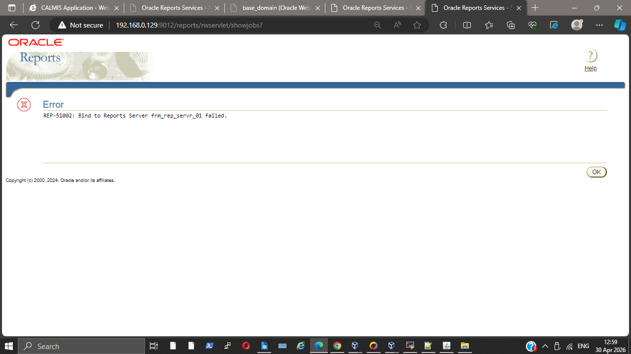

REP-51002: Bind to Reports Server frm_rep_servr_01 failed.
Tony007Apr 30 2026 — edited Apr 30 2026
hi am having this error when starting report severs am in oracle froms 14c
LOG=/usr1/Oracle/Middleware/user_projects/domains/base_domain/servers/rep_wlsalpha/logs/rwserver_diagnostic.log
# Last 150 lines — the death is at the end
tail -150 $LOG

[2026-04-30T14:51:46.464+02:00] [reports] [INCIDENT_ERROR] [REP-50125] [oracle.reports.server] [tid: 1] [ecid: 6afffc02-c08a-4bc6-90e4-e82a6f075922-00000002,0] REP-50125 : java.lang.NullPointerException: Cannot invoke "javax.naming.directory.Attribute.get()" because the return value of "javax.naming.directory.Attributes.get(String)" is null [[
at oracle.security.audit.config.dynamic.persistence.internal.ldap.AuditStoreEntityMapper.convertToXlfFileBinary(AuditStoreEntityMapper.java:693)
at oracle.security.audit.config.dynamic.persistence.internal.ldap.AuditStoreDataManager12_1_3Impl.getXlf(AuditStoreDataManager12_1_3Impl.java:87)

[2026-04-30T14:51:46.464+02:00] [reports] [ERROR] [] [oracle.reports.server] [tid: 1] [ecid: 6afffc02-c08a-4bc6-90e4-e82a6f075922-00000002,0] SecurityHelper:start Writeable folders not configured. Output destination to 'File' will fail.
[2026-04-30T14:51:49.956+02:00] [reports] [INCIDENT_ERROR] [REP-50600] [oracle.reports.server] [tid: 1] [ecid: 6afffc02-c08a-4bc6-90e4-e82a6f075922-00000002,0] REP-50600 : Broadcasting is disabled. Please enable cosnaming for Reports discovery. [[

[2026-04-30T14:52:33.081+02:00] [reports] [INCIDENT_ERROR] [REP-50125] [oracle.reports.server] [tid: 1] [ecid: 19f494c5-d4f2-4caa-9e3b-833945b9bee0-00000002,0] REP-50125 : java.lang.NullPointerException: Cannot invoke "javax.naming.directory.Attribute.get()" because the return value of "javax.naming.directory.Attributes.get(String)" is null [[

[2026-04-30T14:52:33.082+02:00] [reports] [ERROR] [] [oracle.reports.server] [tid: 1] [ecid: 19f494c5-d4f2-4caa-9e3b-833945b9bee0-00000002,0] SecurityHelper:start Writeable folders not configured. Output destination to 'File' will fail.
[2026-04-30T14:52:36.195+02:00] [reports] [INCIDENT_ERROR] [REP-50600] [oracle.reports.server] [tid: 1] [ecid: 19f494c5-d4f2-4caa-9e3b-833945b9bee0-00000002,0] REP-50600 : Broadcasting is disabled. Please enable cosnaming for Reports discovery. [[
