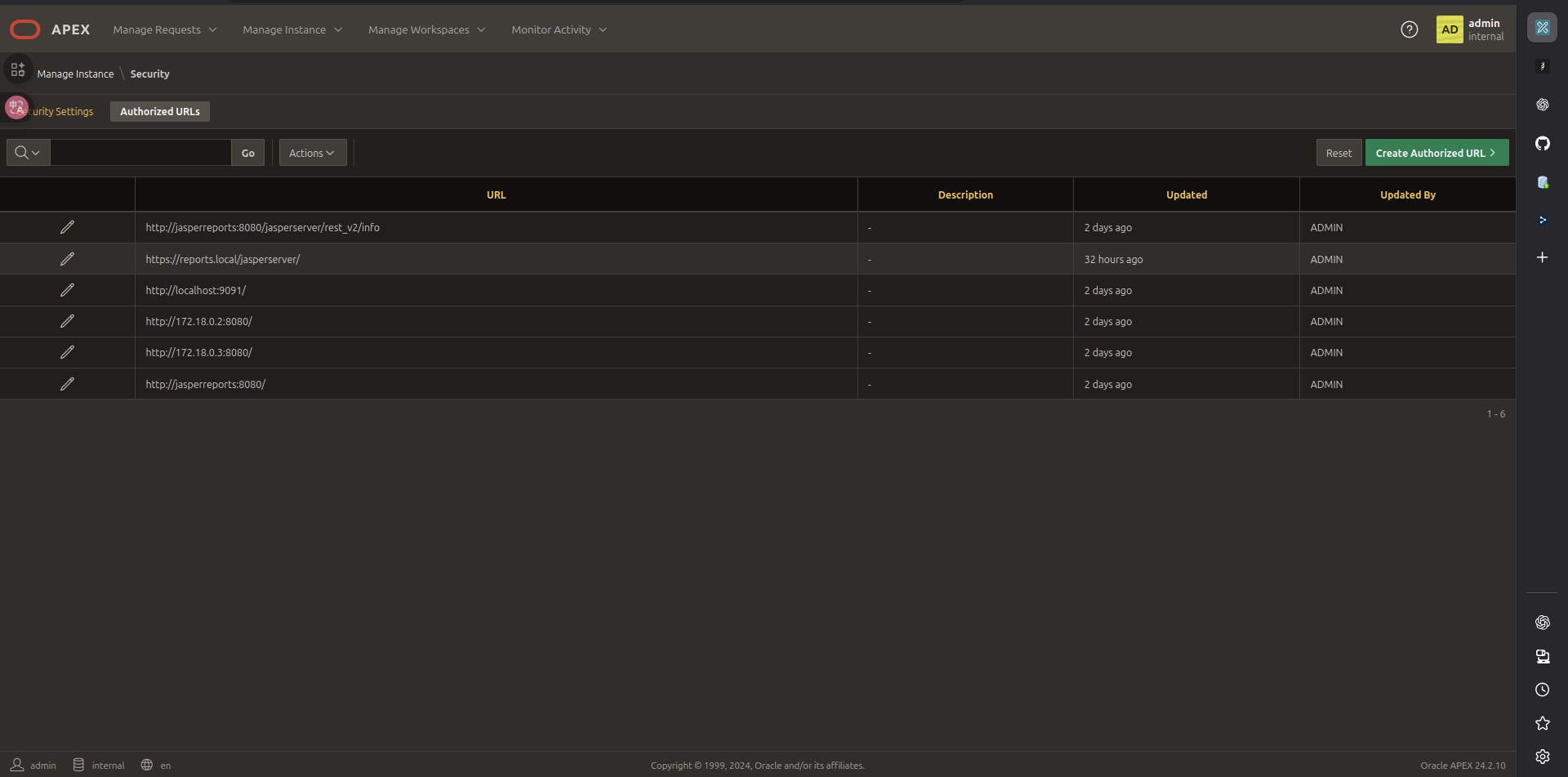

Issue 1 — ORA-20987 when calling HTTP internal Docker hostname
l_response := APEX_WEB_SERVICE.MAKE_REST_REQUEST(
    p_url         => 'http://jasperreports/jasperserver/rest_v2/info',
    p_http_method => 'GET',
    p_username    => 'jasperadmin',
    p_password    => 'jasperadmin'
Result:
ERR: ORA-20987: The requested URL has been prohibited. Contact your administrator.
APEX blocks the request even though Docker networking works fine.

  1. What configuration in APEX 24.2 triggers ORA-20987?
    • Is there a built-in URL allowlist that must be updated?
    • Does Autonomous Database Free (Docker version) enforce stricter outbound rules?
