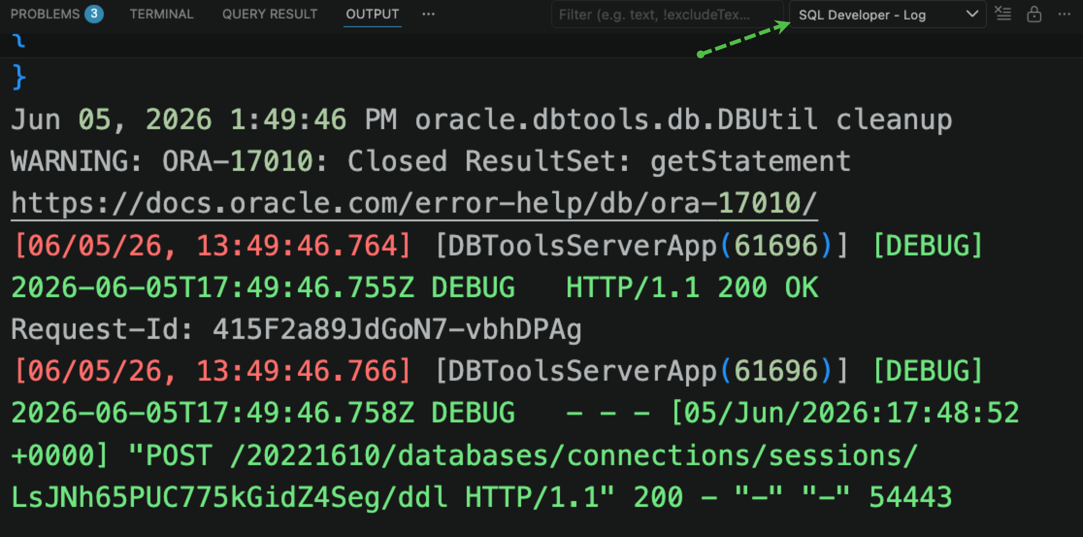

VS Code has an Output panel.
This contains the output from everything running in the VS Code instance, including our extension. If our backend server is having problems, they will be reported here.

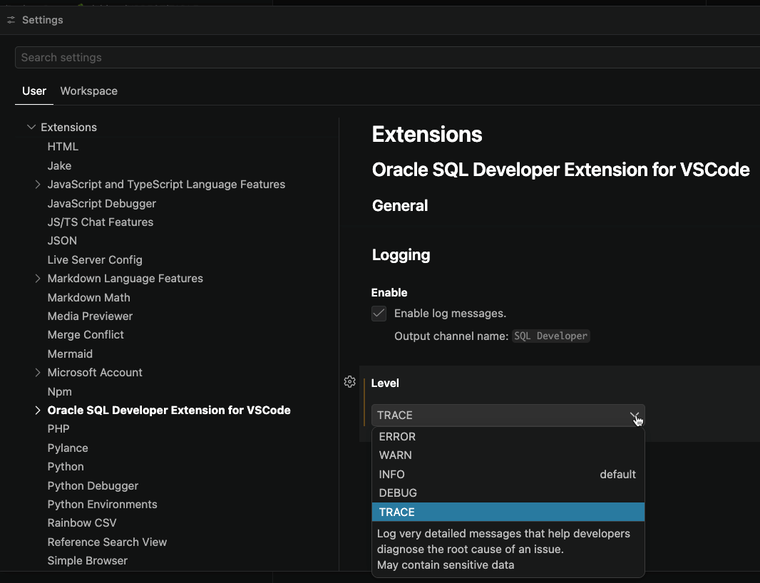

To set the logging level to TRACE (the highest, most verbose setting), open VS Code settings.
Jump to extensions, and the SQL Developer section.
On the first page -
You can optionally configure the logs to be written to a file. Either way, we need to output generated by the extension.
