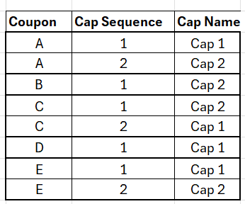

  3. Each coupon is subject to 1 or 2 caps. If it is subject to 2 caps, there is a specified sequence to apply caps.

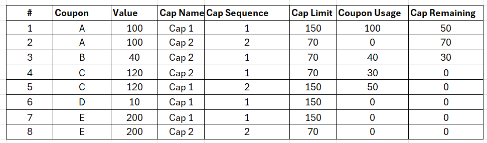

    So, If I join the tables above
    1. I am trying to compute the last 2 column values.
    Explanation:
    Row #1 : Coupon A has a value of 100 and that is less than the first cap i.e. Cap 1 with a limit of 150. So we use all of Coupon A. Cap 1 has a limit of 50 remaning.
    Row #2: Coupon A was all used against Cap 1 and we did not have to consume Cap 2.
    Row #3: Coupon B of value 40 and it is less than Cap 2 with a limit of 70. So we use all of Coupon B. Cap 2 has now 30 remaining.
    Row #4: Coupon C has a value of 120. It is subject to Cap 2 first that has 30 remaining. So we use 30 and Cap 2 now has 0 remaining. Coupon C has (120 - 30) i.e. 90 residual value remaining.
    Row #5: Coupon C has a 90 value remaning that is now capped against Cap 1 with a 50 limit. So we use 50 and Cap 1 becomes 0
    Row #6 - #8: Caps have become 0. Nothing can be used.
I am able to make this work using analytical function with a single cap. The 2 caps with a possibly different usage sequence has me stuck.

, coupon_cap_mapping(coupon, cap_sequence, cap_name) as
select 'A',1,'Cap1' from dual union all
select 'A',2,'Cap2' from dual union all
select 'B',1,'Cap2' from dual union all
select 'C',1,'Cap2' from dual union all
select 'C',2,'Cap1' from dual union all
select 'D',1,'Cap1' from dual union all
select 'E',1,'Cap1' from dual union all
select 'E',2,'Cap2' from dual
