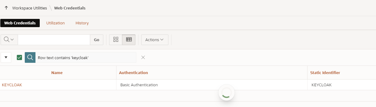

My Credential Static ID is KEYCLOAK and correctly labelled in the code

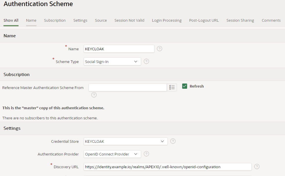

My current authentication scheme is (1) social sign-in (2) Switch in Session = Enabled (3) called KEYCLOAK and again correctly referenced in the code (4) Note APEX10 in the URL
What I want to happen
1. The Authentication scheme has APEX10 in the Discovery URL
2. I want to use my_auth_config to switch to the Discovery URL with APEX11 in the URL

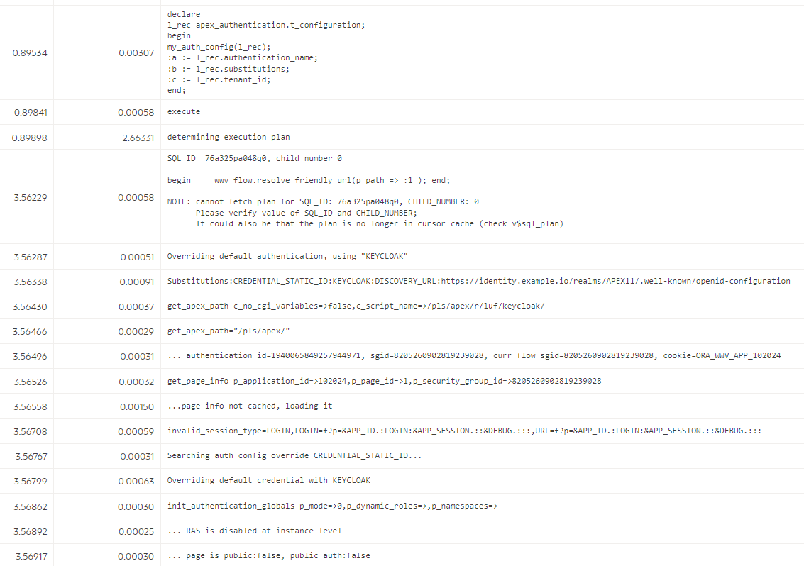

APEX is performing the substitutions but not the Discovery URL
When debugging on LEVEL9 this is what I see
I see that
  1. The default authentication has been correctly overridden with KEYCLOAK
  2. The substitutions, including the APEX11 discovery URL has been extracted from the procedure
  3. The default credential has been correctly overridden with KEYCLOAK
  4. No attempt has been made to override the discovery URL
