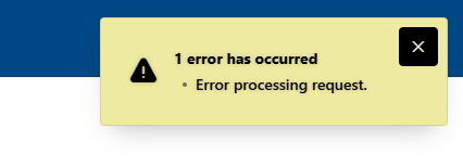

PROBLEM:
* I cannot show the correct error in apex, telling the user that the SUM should be 100.
* I always receive this error in APEX:
Error Message
1 error has occurred
* Error processing request."
* If I try to use RAISE APPLICATION ERROR instead of APEX_ERROR, it's the same.

I think the problem is because the error is being generated in the STATEMENT only when the COMMIT happens (Deferred constraint)…Maybe apex cannot handle it properly.
Do you guys have any idea on how to “capture” that error from the trigger?
I need to tell the user that the problem was the SUM not being 100%… Right now, it only shows “Error Processing Request”
