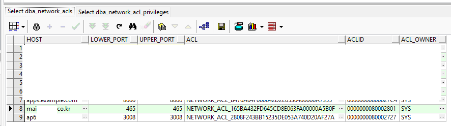

1. First, I registered the information of the mail and wallet tabs in the internal instance. The smtp server I use requires SSL authentication.
2. ACL registered in DB.
begin
dbms_network_acl_admin.append_host_ace(
	host => 'mail.nlcbiz.co.kr',
	lower_port => 465,
	ace => xs$ace_type( privilege_list => xs$name_list('connect'),
						principal_name => 'APEX_230200',
						principal_type => xs_acl.ptype_db));
end;
3. A wallet was also created.
mkstore -wrl /home/oracle/wallets -create
4. After completing all the setup and performing many tests, the problem was not solved. However, the part I don't understand is that when executing validation of the server settings, the following results appear.
I doubt this error is causing the problem, but I haven't found any workarounds or references for the error.
I showed all my work. However, it is difficult to understand why this error occurs, and it is difficult to find a reference for this error.
Do you happen to know how to solve this problem?
