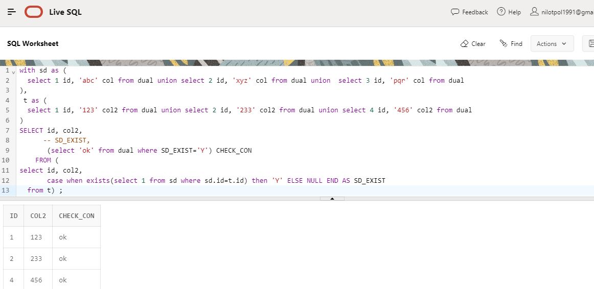

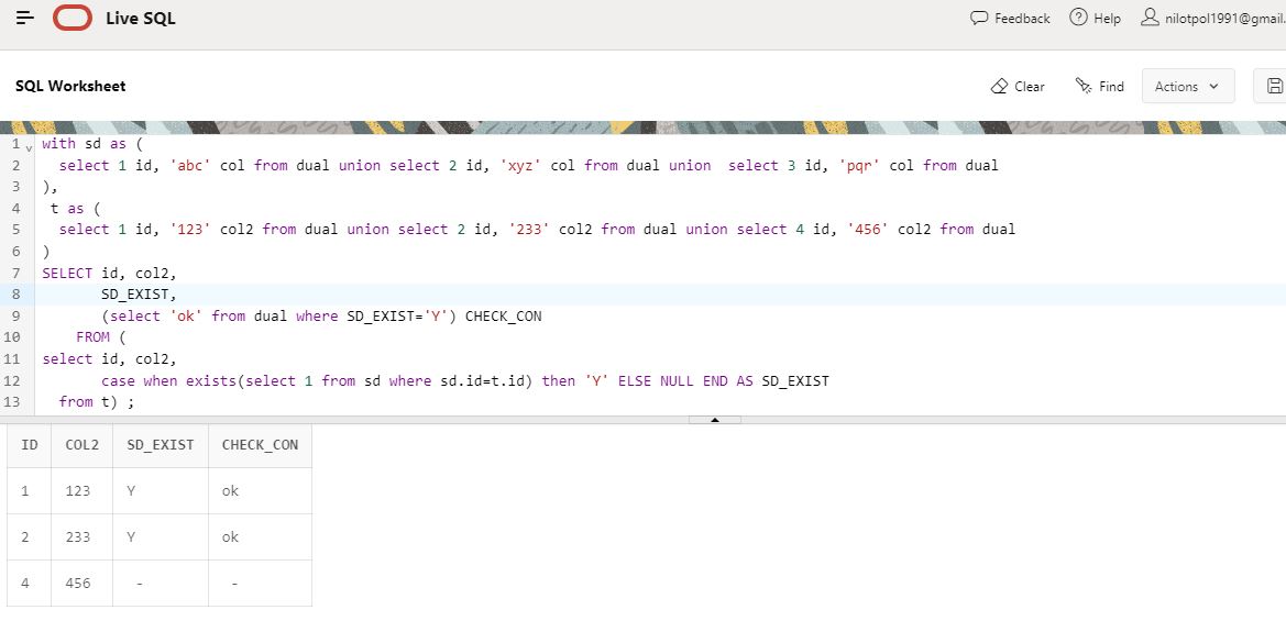

But the output of final query CHECK_CON column changes
– if SD_EXIST is included in projection of select, CHECK_CON is null (for id 456) - Here the query behavior is working fine.
- if SD_EXIST is commented (not included in projection of select), CHECK_CON is ok (for id 456)- Here output is different and shows weird behavior of the query.
Can you explain the working here?
