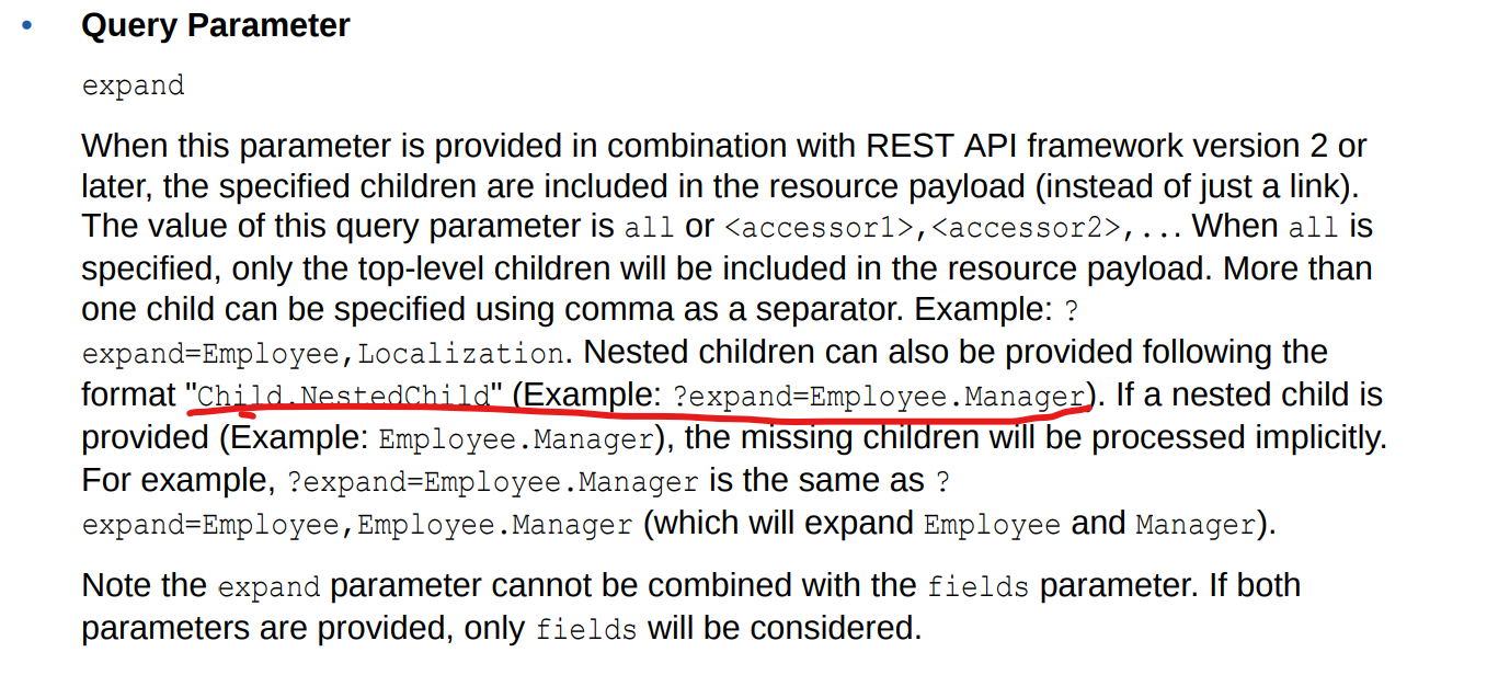

It says in the documentation that I can use “expand” parameter to get child and grandchild.

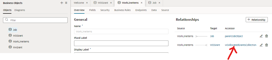

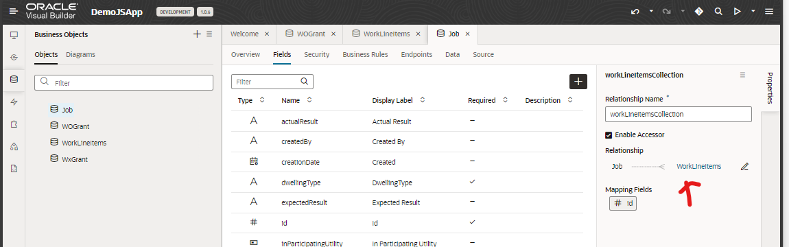

I have Job (root), Work Line Item (child), Grant (grandchild).

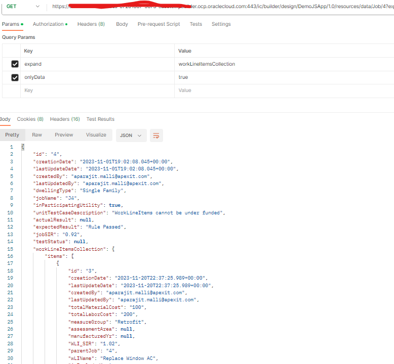

When I use expand = all on get all "Job", it gives all jobs and Work Line Item for each Job.. Great!

I tried the dot notation like given in the documentation below, but it is not working.
Below dot notation

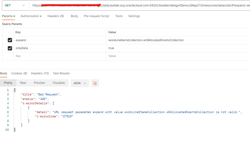

"expand=workLineItemsCollection.wOAllocatedGrantsCollection" is not working.
1 level (child) is working. expand=workLineItemsCollection
