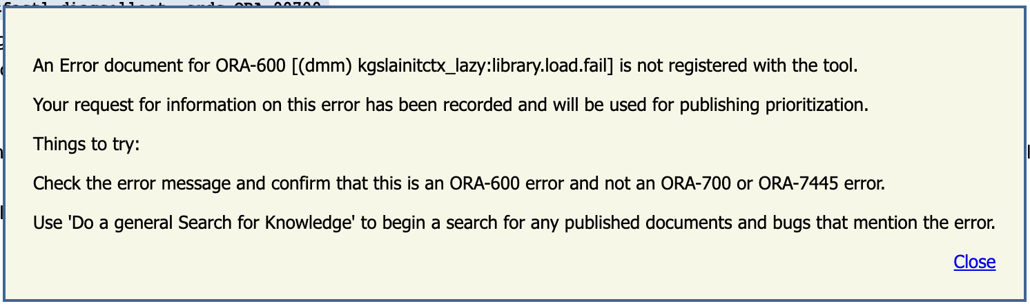

Checking the alert log and associated trace file shows:
ORA-00600: internal error code, arguments: [(DMM) kgslaInitCtx_lazy:library.load.fail], [], [], [], [], [], [], [], [], [], [], []
And looking this up with the ORA-00600 lookup tool on MOS shows:
But going to the incident trace file shows the actual problem:
(DMM) kgslaInitCtx: skgdllOpen /opt/oracle/product/23ai/dbhomeFree/lib/libora_netlib.so OS error: 79 Error message: Can not access a needed shared library          OtherInfo: libgfortran.so.5: cannot open shared object file: No such file or directory
And from there, the solution is quite obvious:
dnf install gcc-gfortran
Then it works and the DBCA completes successfully.
