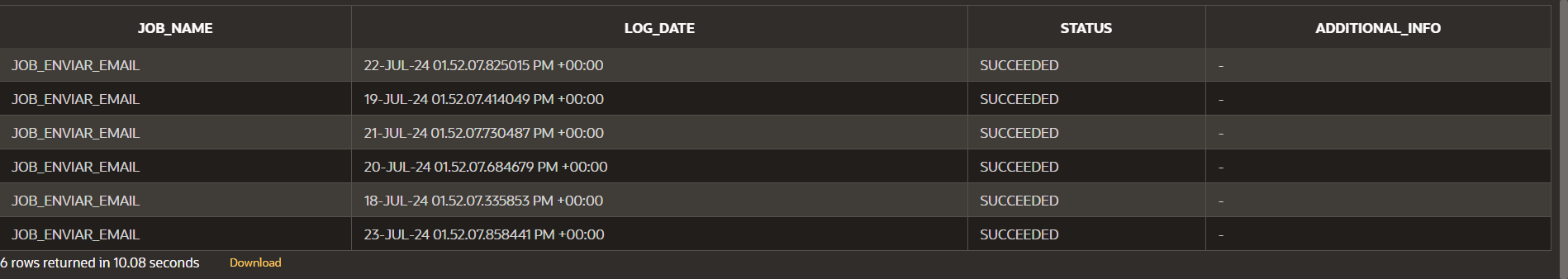

Problem executing my job DBMS_SCHEDULER.create_job
I am creating a job to execute a procedure that sends emails to email addresses registered in the database. When I run the procedure, everything works fine, but when I schedule the job to run, nothing happens, even though the job status is "executed".
I've read the documentation but I can't understand why. My job below:

Does anyone have any tips or ideas on what could be going wrong?
