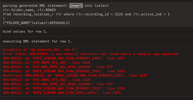

I load the page and it looks great. I select Add Row to the Interactive Grid and type a new Folder Name, when I then click Save within the Interactive Grid, I get the ORA-01858 error. In the debug, I see this:
My recording_location_r table is set with folder_name to be varchar2(255):
If I take that exact select/ insert, drop it into SQL Developer and change :APEX$VAL2 to ‘test’,and :P102_RECORDING_ID_IN to something real, the insert works just fine (my recording_location_r_id field is setup with a trigger and sequence).
I even hard coded a RECORDING_ID in my SQL to test, but I get the same error (the debug shows this):
How can I see the actual SQL that was executed? I thought it would be in this debug window, but I can't see what happens after the bind steps. I'm using APEX 22.2.4, and an Autonomous Database - both in OCI. When I look on cloud.oracle.com at the database performance hub > SQL Monitoring, it says 'No monitored SQLs found'… How can I set an APEX SQL to be monitored?
