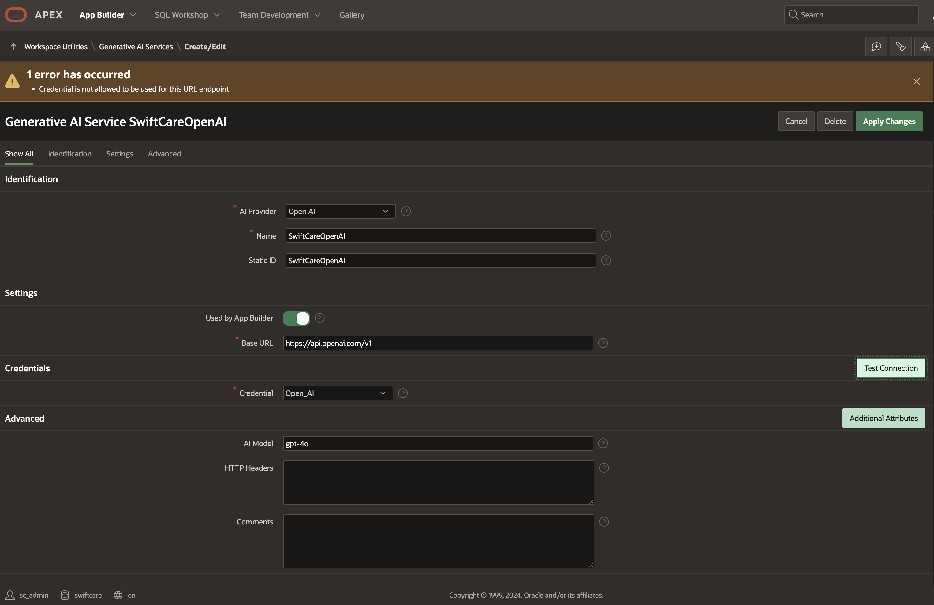

Then I configured a Generative AI Service using that credential. However, when I test the connection, I am getting following error:

Curl from inside the container works (returns HTTP 200 when I include the same Bearer header), so I know the key and network are fine. What configuration step could I be missing in APEX so that MAKE_REST_REQUEST still fails with ORA-29273?
