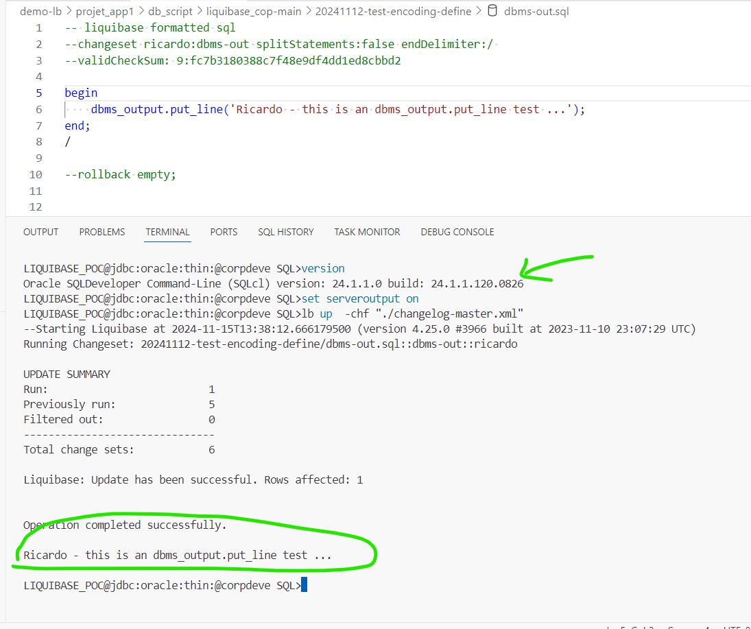

  3. managemet of dbms_output aka set serverouput on. within our scripts we have sometimes messages that are outputed and we need to keep those in the context of deployement log. within the context of sqlcl when we run liquibase command if prior execution of the script we execute the set serveroutput on , we ended with exactly what we need . With the version 24.1.1 that is ; with latest version no output at all are returned
    ( Problem with latest version / regression )
LIQUIBASE_POC@jdbc:oracle:thin:@corpdeve SQL>version
Oracle SQLDeveloper Command-Line (SQLcl) version: 24.1.1.0 build: 24.1.1.120.0826
LIQUIBASE_POC@jdbc:oracle:thin:@corpdeve SQL>lb up  -chf "./changelog-master.xml"
--Starting Liquibase at 2024-11-15T10:00:51.227452400 (version 4.25.0 #3966 built at 2023-11-10 23:07:29 UTC)
Running Changeset: 20241112-test-encoding-define/dbms-out.sql::dbms-out::ricardo
UPDATE SUMMARY
Run:                          1
Previously run:               5
Filtered out:                 0
Total change sets:            6
Liquibase: Update has been successful. Rows affected: 1
Operation completed successfully.
Ricardo - this is an dbms_output.put_line test ...
I'm sure you will be able to reproduce easily ; providind here just for reference the sql changeset we are using to test this behavior :
-- liquibase formatted sql
--changeset ricardo:dbms-out splitStatements:false endDelimiter:/
--validCheckSum: 9:fc7b3180388c7f48e9df4dd1ed8cbbd2
begin
dbms_output.put_line('Ricardo - this is an dbms_output.put_line test ...');
end;
--rollback empty;
thanks in advance for the support.

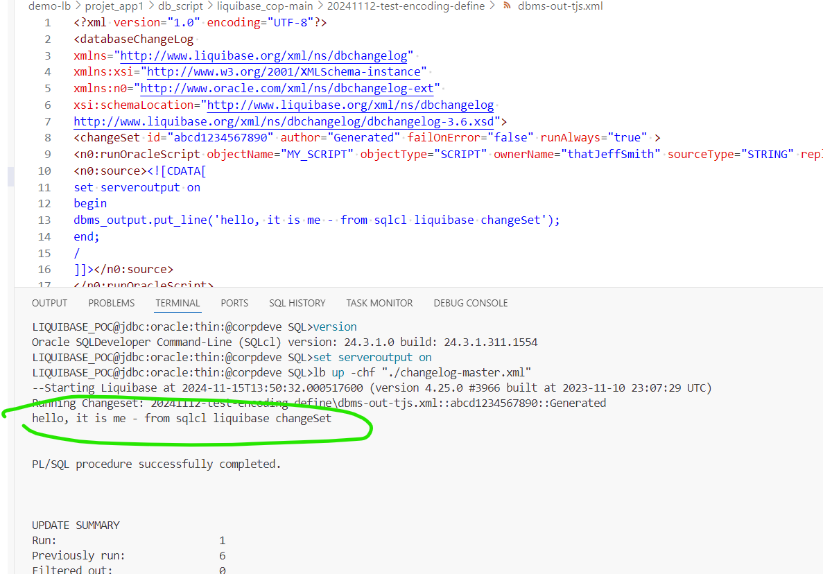

I can test a dbms_output run for you, but 24.3.1 (it works) is the latest. Your version of SQLcl is about 8 months old
dbms_output from sqlcl script changeset
the changeSet:
<?xml version="1.0" encoding="UTF-8"?>
<databaseChangeLog
xmlns="http://www.liquibase.org/xml/ns/dbchangelog"
xmlns:xsi="http://www.w3.org/2001/XMLSchema-instance"
xmlns:n0="http://www.oracle.com/xml/ns/dbchangelog-ext"
xsi:schemaLocation="http://www.liquibase.org/xml/ns/dbchangelog
http://www.liquibase.org/xml/ns/dbchangelog/dbchangelog-3.6.xsd">
<changeSet id="abcd1234567890" author="Generated" failOnError="false" runAlways="true" >
<n0:runOracleScript objectName="MY_SCRIPT" objectType="SCRIPT" ownerName="thatJeffSmith" sourceType="STRING" replaceIfExists="false">
<n0:source><![CDATA[
set serveroutput on
begin
dbms_output.put_line('hello, it is me - from sqlcl liquibase changeSet');
end;
]]></n0:source>
</n0:runOracleScript>
</changeSet>
</databaseChangeLog>

I re-did some tests with you changeset and turns out we are both right . actually within the context of an xml changeset the output is correctly displayed as you mentionned and referenced below in annex:image1
however when we are using sql changeset we don't see the same behaviour in the latest version. reference below in annex:image2 . But we use to in the older version as annex:image3
