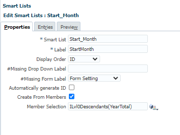

I have read the previous post:@HspNumToString - error in Calc Manager Script, but I am on EPBCS now.
I have ticked “create from members”, and my rule is as follows:
