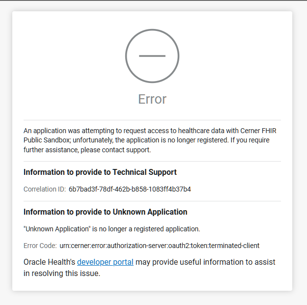

I'm trying to make a patient login to my system and upon the login I want them to provide consent and get access token to follow up the R4 requests.
Actual Problem:

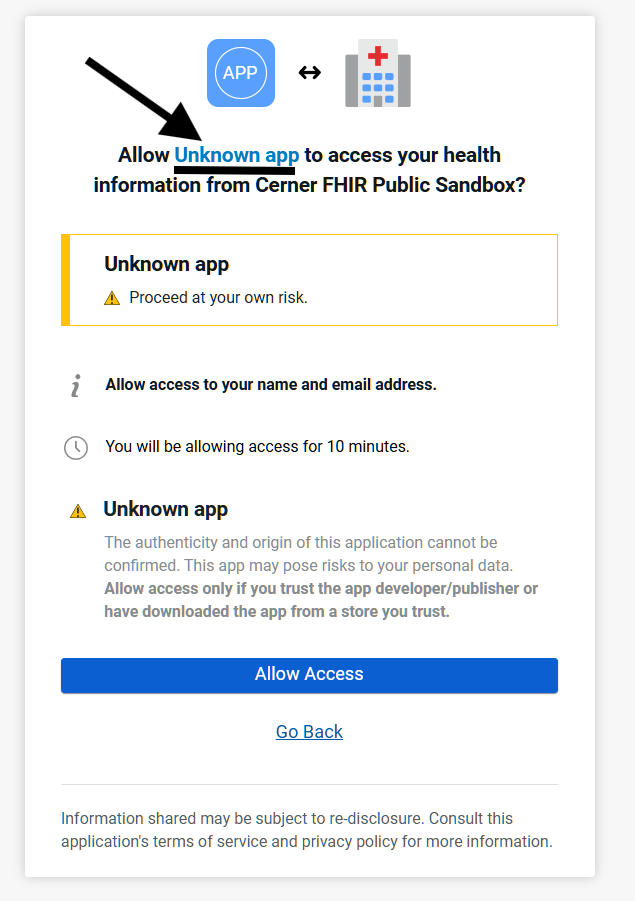

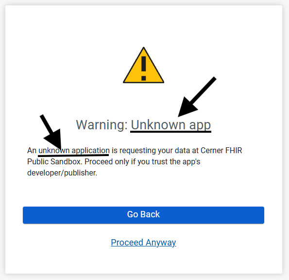

I've been facing issue that the registered app is not being recognized instead it is showing as Unknown App.

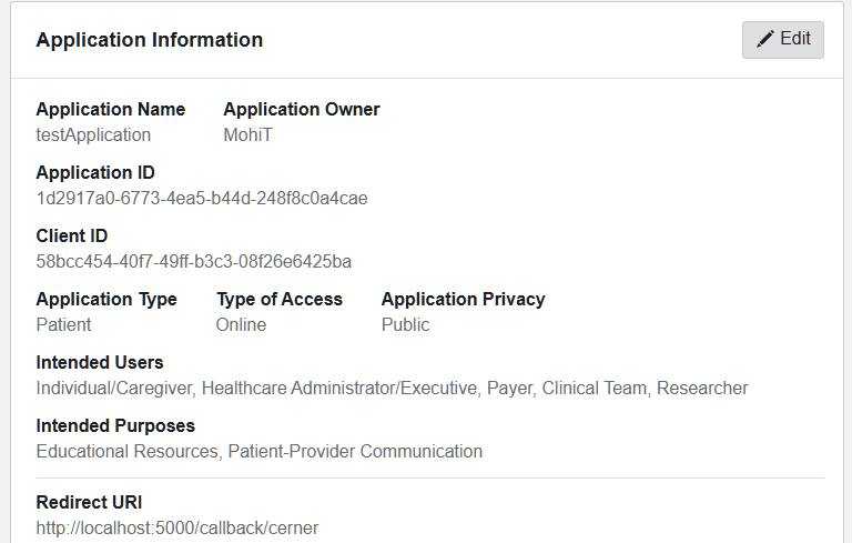

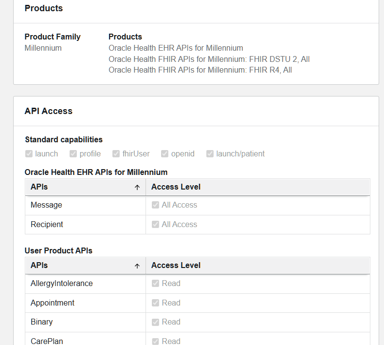

Description: I developed an application with these configurations from this link: [EVERYTHING IS IN TESTING ENV]
And upon referring to the documentation, I formed this URL that takes me to the login page and provides the consent:

Upon redirection following happens:

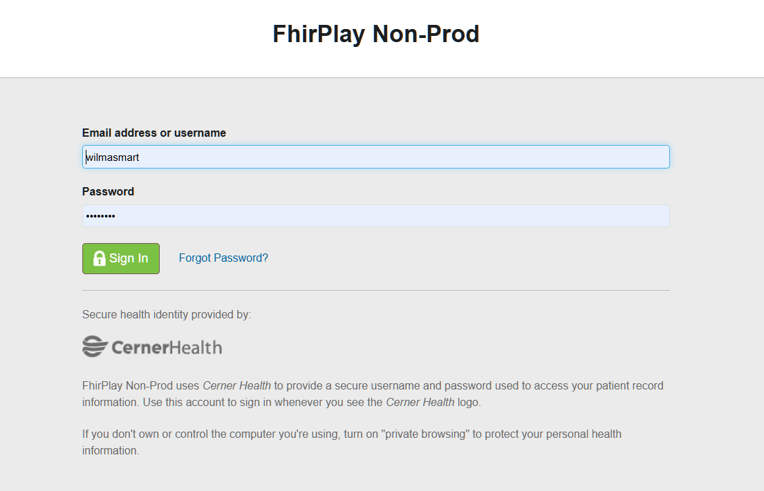

1: Login Page
2: Unknow app issue,
3: Upon Proceed Anyway, I get still the unknown app issue

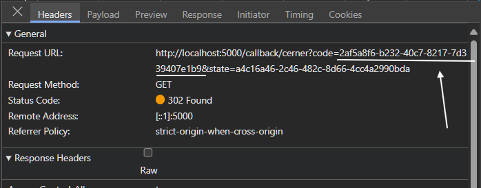

4: Callback gives the code

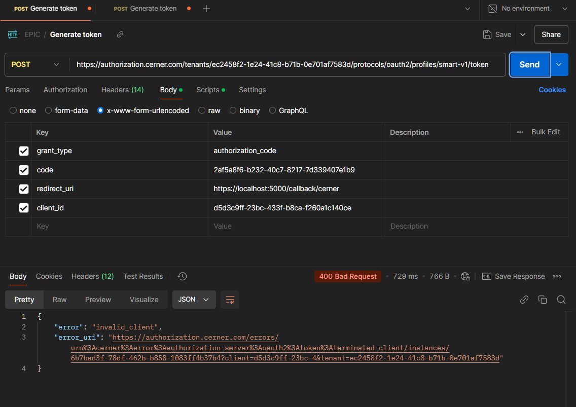

5: But upon using the code for /token to get the access_token I'm getting this error:
Upon opening the link, it shows the same error of unknow app:
Expected Result: access_token and other fields
Actual Result: "error": “invalid_client”
What am I doing wrong here, I saw the similar issue with a lot of issues but nothing seems to work out perfectly, even the solution regarding the TXT records.
I'm unable to get that what value and target do I put in the TXT records.
If the issue is something else or my flow is wrong, then kindly help me with it.
