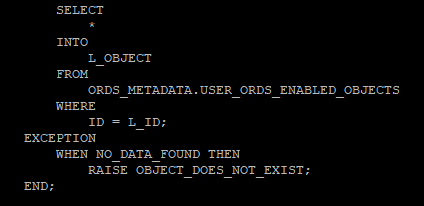

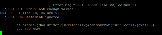

When trying to enable authentication on a Autorest enabled object we get a ERROR 555
Whe we examine the logs we see
Examining the code it is running further up in the logs we can see the error is on the below statment
L_OBJECT is decalared as L_OBJECT ORDS_METADATA.USER_ORDS_OBJECTS%ROWTYPE;
When I describe L_OBJECT ORDS_METADATA.USER_ORDS_OBJECTS I get

Obviously not the same collumns…….. So I know the cause of the issue but this is autogenerated code by ORDS so no idea how to fix it.
Can anyone point me toward a known bug? or give me some advice on how to handle this. So far my searching has turned up blank.
