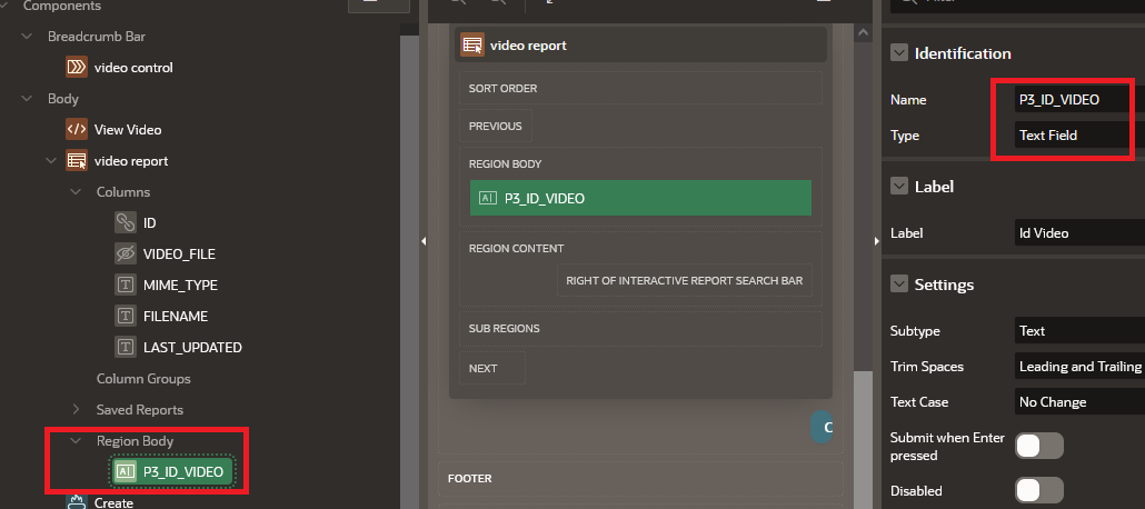

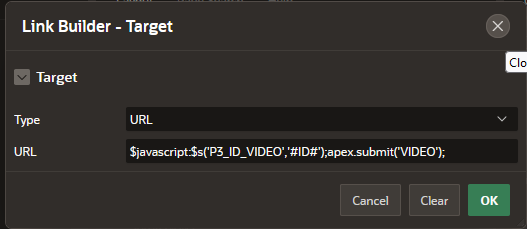

I changed the (ID) column in the interactive report page – or the video ID – type to (link)
And made target type (URL) and the URL as shown below where P3_ID_VIDEO is a page item in the interactive report to hold the video id during runtime.
At the runtime the screen will be like this
I have to click on the (id) link to pass the video ID to the static region above and then the HTML source code will display the video from the BLOB column.
But there is a runtime error said it didn’t find the video
As shown above in the URL, it have a P3_ID_VIDEO = 21, BUT THE VIDEO WAS NOT FOUND, THE ERROR IS HTTP STATUS CODE 404
