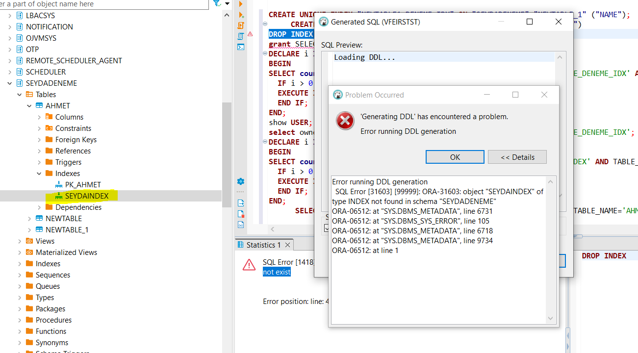

We created unique index with ef core in oracle . Now , we want to modify index. but When ı tried the drop index , we are getting error "ORA-01418: specified index does not exist". When I executed create index script on dbeaver manually everything is ok and later drop index script also works .
( CREATE UNIQUE INDEX "SEYDAINDEX" ON "SEYDADENEME"."AHMET" ("NAME"))
So there is a problem when I create it via EF Core. How can I drop the index, what is the problem in creating index with efcore?
Also when we create with efcore, I can view index on dbeaver , there is index. But When I try to create ddl, I get the following error.
ef core migration code:

Oracle.ManagedDataAccess.Client.OracleException (0x80004005): ORA-01418: belirtilen dizin mevcut değil
ORA-06512: konum  satır 5
