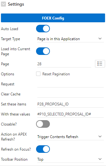

  • In the East Pane of that page are are 3 FOEX Content Loader Regions (shown as tabs)
  • Those reference additional pages, which are based on FOEX Form regions
  • For each of those CL regions, we're passing the parameters in the CL definition (see screenshot), via
    • Set these items
    • With these Items
This works fine for the first 2 CL regions (i.e. they refresh with the correct record shown), but the third doesn't seem to get the Set Value passed. The region refreshes, but doesn't show a record. When I check session state (via Apex Debug), the page item's value is null.

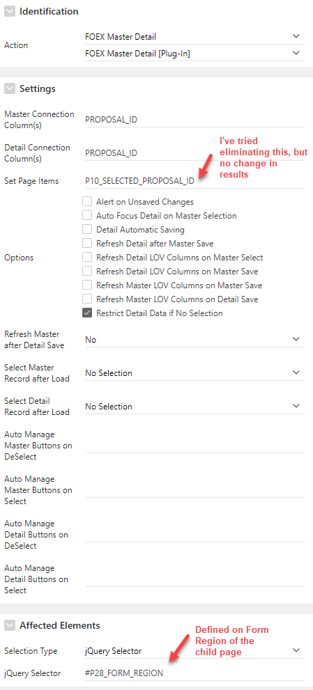

We also have a Master-Detail relationship set up for 2 of these 3 CL regions. Only 1 of the 2 that's working has an M-D DA. The one that doesn't work also has an M-D DA (second screenshot).
The strangest part is that the application worked fine when I run from the Apex Development Environment (e.g. Run Application), but fails when I run it outside Apex (using a Private browser window on the same Apex/database instance).
