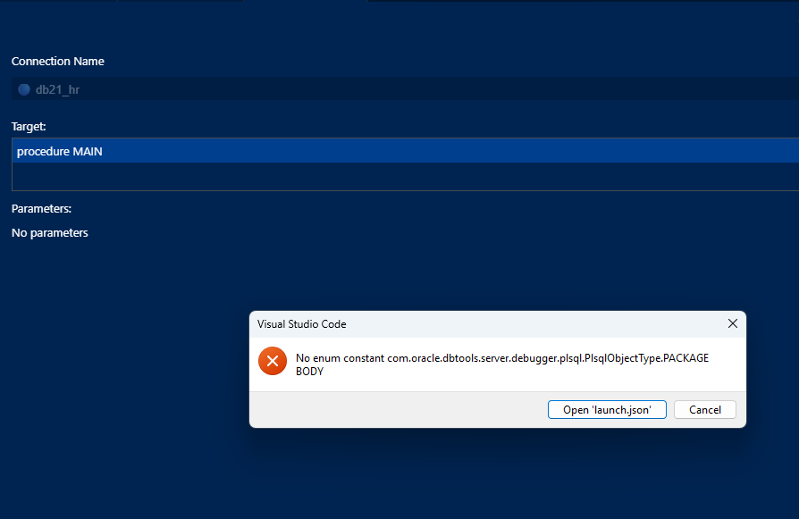

Debugger - error when debug package from files
  1. I created a package in the database, and then saved the specification and body as files on disk.
  2. I dropped a package from the database
  3. I opened spec and body from local files created at 1
  4. run debug
  5. compile for debug
  6. ERROR
package pkg_test.pks
create or replace package pkg_test is
    procedure main;
end;
package body pkg_test.pkb
create or replace package body pkg_test is
procedure main is
begin
    for i in 1..10 loop
       dbms_output.put_line(i);
    end loop;
end;
end;
I'm not sure if it is a bug or I did sth wrong but I definitely need help here :)
