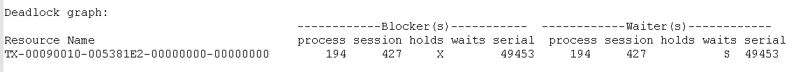

In our production DB, deadlock was detected in database alert log/trace file. The trace file shows that the same session, process and serial # are locking each other out . The call stack and deadlock graph are shown below:

Deadlock graph:
